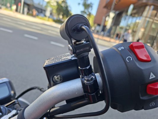

    I initially installed the K7 front camera using the supplied L-bracket. I found the resulting image quality to often be severely affected by vibration. My bike (Triumph Speed 400) has bar-end mirrors, with unused 10mm mount points for regular mirrors, so I replaced the L-bracket mount with a far more solid mirror adapter (10mm reverse thread to 8mm normal thread), drilled out the Innov block to fit the 8mm bolt, and the result is noticeably less vibration in the image. It’s still not fantastic, but much improved.
    Here’s an example travelling through a Sydney road with the usual terrible drivers and bumpity-bump: (the “before” video is with the L-bracket, notice the whole image shakes around a bit)
    before (L-bracket): https://youtu.be/cZPzfXzJlo4 (*)
    after (solid mount): https://youtu.be/njtUJdbYn0A

    Hi Ben,
    Thanks for sharing your info/tip about mounting it on the Triumph Speed ​​400.
    Vibrations on a motorcycle are always a nightmare for videos.
    It often depends on how and where the camera is positioned. Protruding parts of a motorcycle (handlebars, indicators, etc.) often also amplify vibrations. The same applies to plastic covers.
