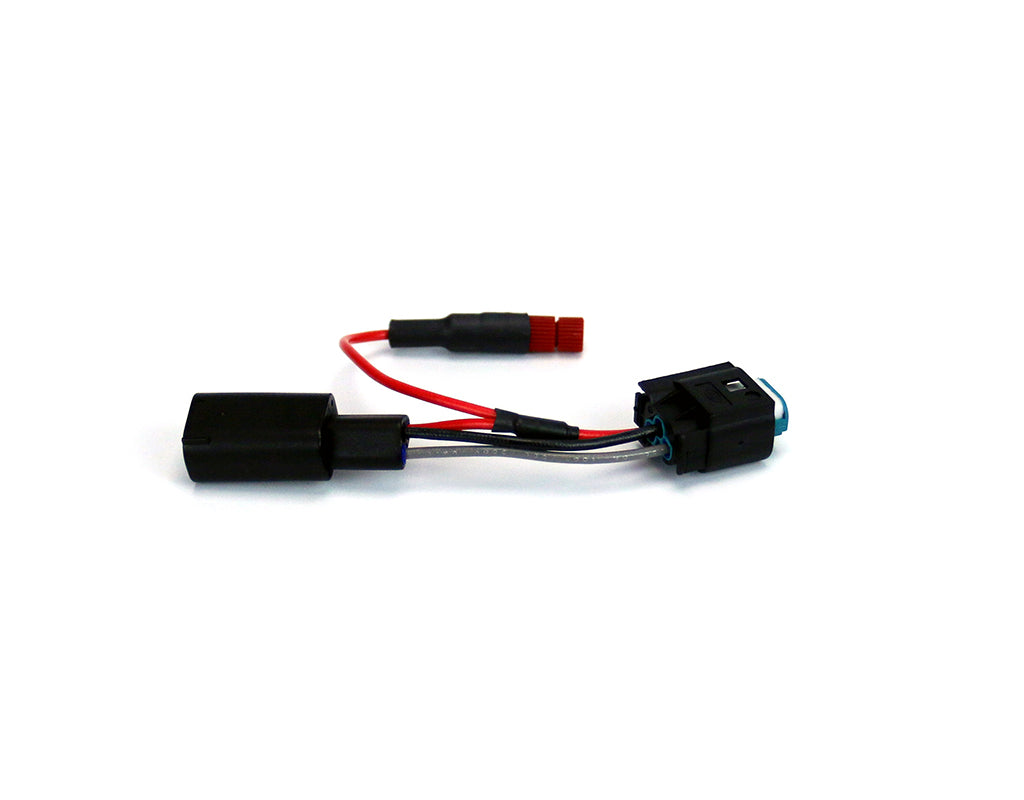

      Sorry, I’ll do it right away, I’ll use Google TranslateGood evening, I just received my K7 and I’m wondering how to distinguish the front camera from the rear camera. I then purchased this Denali cable (yellow cable) to connect it via the cable that carries power to the navigation system. Is this correct? Thanks, regards, Armando.

    I don’t have experience with Denali. But it’s important that the black and red wires have continuous power. The yellow wire must have a switched power supply that switches with the ignition. If your navigation system switches with the ignition, you can use this power supply to switch the K7 as well.
