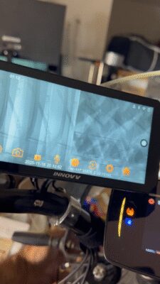

    Hello,
    After almost 1 day trying to figure out how to install the N2 system onto a Harley Davidson LiveWire ELW.
    I was able to power up the unit but upon my un pleasant surprice. This is the image the cameras are displaying (see video).
    I have update the firmware on the N2 as well as changed the resolution. Nothing seems to work, is there a software fix for this or is this unit bad. I really do not think 2 cameras are bad at the same time?
    Any suggestions will be greately appreaciatted!

    Hi Diego,
    This is definitely not how it should be.
    To be sure, you can check for any damage to the wiring. You can also disconnect the cameras one by one and see what happens.
    But I suspect this will be a warranty issue.
    If you purchased the N2 directly from Innovv, you can contact Innovv at [email protected] or submit a ticket at https://innovv.com/pages/submit-a-ticket
    I’d like to hear if and how this has been resolved.

    Mine did this (1080p cameras) i changed the settings to 2k, allowed it to reboot and then changed it back. Allowed a reboot and that fixed it

    Did you get a solution for this? I’ve just installed mine and its done exactly the same front and rear. It’s also not finding the tyre sensors when I try to sync them. I’ve emailed Innovv initially to see what their response is going to be as I’m not sure if its the main unit. It’s also not screen mirroring when I connect to Android car play.

    Just got the kit and have the exact same issue. Tried every configuration of the cameras and no luck. Did you ever get a fix sorted out?

      Hello, what camera do you have? 1080P or 2K?

    Wie schon von anderen beschrieben, Die Einstellung der Kamera au 2k oder 1080 ändern, je nachdem du welche kamera hast
