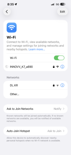

    Additionally, you mention that you are having many problems but that it also works well. So what has changed that it no longer works? Have you changed a setting on the K7 or on your phone? Or started using a different phone?
    The K7 does not connect via cellular data, so that cannot be the cause.
    But to help with solutions:

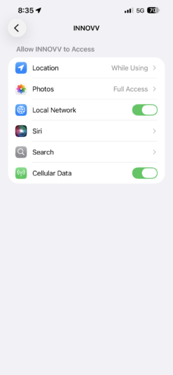

    Do you have a virus scanner/firewall or a PN enabled? These are also often the cause of a black screen in the app.
  • Corey
    2026-04-05 at 23:55
    Well, I kept getting, and still keep getting an error about not being able to post right now. It has always been an issue, and I just dealt with it. Meaning didn’t use it. Yes, it did work that weekend only. Now I have a big ride coming up and wanted to use it, but I can’t. I tried 3 different phones. 2 iphones and a samsung phone. Correct, the buttons meaning the remote control.
  • Corey
    2026-04-05 at 23:57
    So seems I cannot post from my phone. Weird. But oh well.
    I do not have a vpn or firewall installed. I also tried an app called Viidure and same issue. Just get the black screen with spinning wheel.

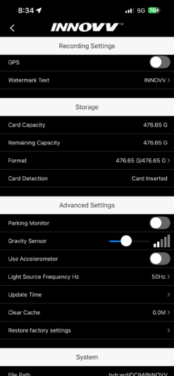

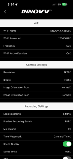

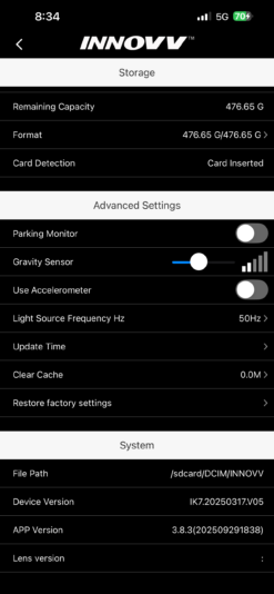

    I see on your screenshots that the SD card is still completely empty. I read that you formatted the SD card using the Innovv app, but did you put the SD card in a computer again afterwards? An SD card that has been read in a computer can also cause problems. So, after reading the SD card in a computer, format the SD card again using the Innovv app. Does the SD card also meet the specs set by Innovv? That is, a write speed higher than U1.
    What happens if you do connect the remote control? Right now, you also have no indication of what is happening. The blinking of the LEDs on the Renote control can also provide an indication of what is going wrong; you are missing this information now.
    • Corey
      2026-04-06 at 00:39
      You are incorrect about the cameras working fine. They do not record at all.
      The SD card is brand new today. A Samsung Evo Plus 128gB. It came out of the package and inserted and formatted right in the K7. Still is in there. That is why there is not anything on the SD card. I cannot take a picture, it fails. The video does not record.
