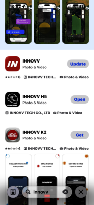

      2025-08-19 at 21:39
      Have you installed the iPhone update of the app?
      That fixed it for me.
  • Kerry
    2025-08-20 at 06:44
    I’m all good now. I place a ticket with support explaining the situation. Next day, they updated the app version to 3.8.1, downloaded it and works seamlessly from the onset. Now I can mount my cameras permanently.

      2025-08-26 at 05:09
      I just downloaded the K2 app on my Iphone14. I still can’t connect the camera to the phone. What’s going on?
        2025-08-26 at 15:21
        Hi George,
        The K2 app isn’t the correct app. You need the “general” Innovv app, the one with the red logo.
        iPhones also sometimes have trouble establishing a Wi-Fi connection with the Innovv camera. Try putting your iPhone in airplane mode and then manually establishing a Wi-Fi connection with the Innovv camera.
