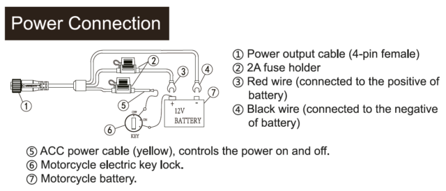

    I currently have a TomTom rider with a two wire power connection. Can I use the two wires to connect an INNOVV N2 ?
    Hans replied 3 months, 2 weeks ago 2 Members · 1 Reply
  • 1 Reply
    2026-05-29 at 02:16
    Hi Chris,
    If these two connections have continuous power, you can use them. However, you will still need a switched power supply.
    If the TomTom Rider has a switched power supply, you can use that as well. You will still need a constant power supply.
    See also the wiring diagram in the manual to see which power supply to connect to which cable.
    Please ensure that the power supplies used are 12V and that the constant power supply can deliver sufficient current, at least 620mA.
