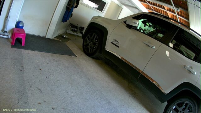

    Attachments provided :
    + Short sample video demonstrating the exact noise issue (file resolution reduced for upload size, but audio is original).
