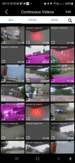

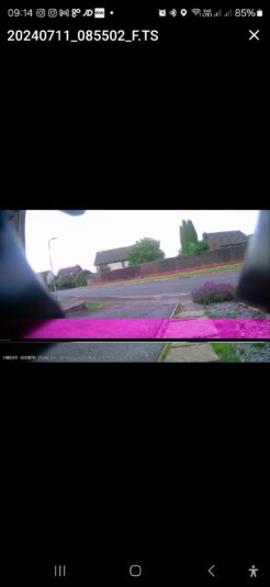

    2024-07-11 at 16:36
    Are there any solutions to this? Mine has started doing this too.
    I’ve done a reset and my SD card is top end SanDisk.
    Had two vans run a red light and nearly take me today out so went to review the clip.
    Nothing but a distorted image that has half a purple screen sheen to it. The video is downloaded incase the app was playing up but all I’ve got is a purple image with no motion. There is no end time on the time line either but it does count up when you press play.
    Only had it fitted 3 months and of that time it’s not had much use.

    2024-07-11 at 20:19
    Hi Christopher,
    The purple image is clearly due to a camera problem. This could be a bad connection, try disconnecting the camera connectors and reconnecting them. This will clean the contacts a bit.
    It may also have been caused by the camera cable being mounted too tightly. Vibration of a cable that is mounted too tightly can cause cable breakage.
    Also check whether the rubber rings are present in the connectors of the cameras. These keep the connectors watertight.
    To rule out that it is the DVR, you can swap the front and rear cameras. If the problem moves along, you know for sure that it is the camera and not the DVR.
