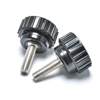

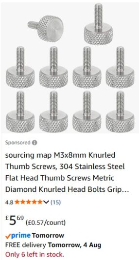

      Many thanks for your very quick reply – I actually found an earlier reply you gave to someone asking the same question. Even though you have to remove the connector cover as you would to access the SD to remove it, it is still easier to connect a USB-C to USB-A cable to the internal data connector as you don’t have to pop out the SD and put it into a reader or adapter and then insert it into your PC/ Laptop. It saves wear and tear on the card slot, although I guess the silicone O ring will wear out eventually. Has anyone sourced replacement screws that can be undone with the fingers so you don’t need to carry a small screwdriver to get the screws out? I was think of knurled cheese head screws, but goodness knows where to source them!
      Like these but very small!

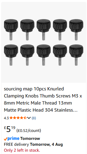

    I found these thumbscrews on Amazon, they are M3 x 8mm, exactly the same size as the standard crosshead screws, but have a nice knurled top so they can be done up and undone using your fingers. I also found some fully stainless steel ones, I have ordered those as well to see which is best. I think the black plastic heads will be more discreet. I will upload a photo when I have fitted them.

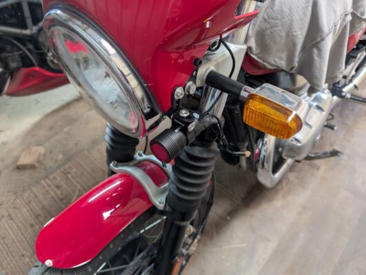

    This is how I have the K6 front camera mounted on my Royal Enfield Interceptor 650. There is free access to get at the connector cover when I have the thumbscrews installed.

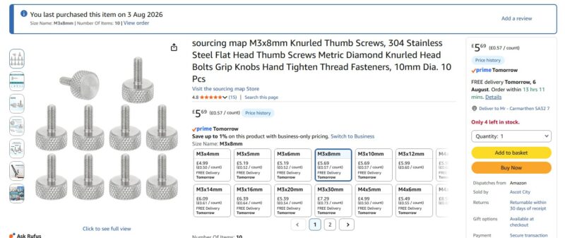

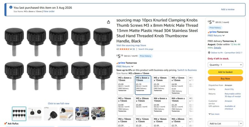

      Hi Hans – the knurled thumbscrews M3 x 8mm I sourced from a seller on Amazon UK. They are being delivered today, so as soon as I have fitted them I will update you with photos of the back of the camera. Here is the listing on Amazon. I also found an all metal alternative which I have ordered as well, and I will choose what seems the best one to use.

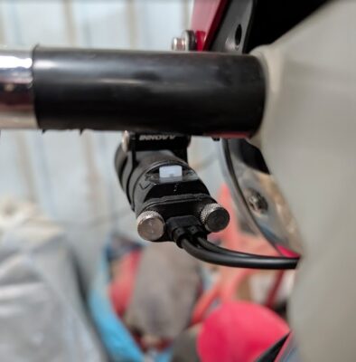

      Hi Hans – I test fitted the thumbscrews last night. Don’t order the black plastic ones, the heads are slightly too large at 13mm, and foul the body of the connector. The all metal ones have 10mm heads and fit perfectly! There is about half a mm clearance to the cable connector. They are easy to unscrew with the fingers and you can do them up pretty tight. Cheers, Steve.

        No problem. The knurled thumbscrews are a massive improvement in access to the connector and card slot.

          It’s also nice to see the videos from your area; it seems like a beautiful region for motorcyclists. Another tip for your front camera: I see that it produces a wobbly image. This is caused by the camera resonating along with the vibrations of the motorcycle. This could be due to, for example, the cables being pulled too tight, or the camera being mounted on a plastic fairing part that can vibrate while riding. I suspect the latter is the case with you. You might be able to prevent this wobble effect by placing the rubber rings between the Innovv bracket and the fairing part. Otherwise, it will be a matter of looking for another place to mount the K6.

            I note your remarks regarding the front camera wobble – I will try your suggestion and see if I can isolate the camera bracket from the fairing mount with some rubber spacers or washers. I’ll let you know if it improves the stability of the image. The rear camera being more rigidly mounted on the pannier frame does not seem to be affected in the same way.
