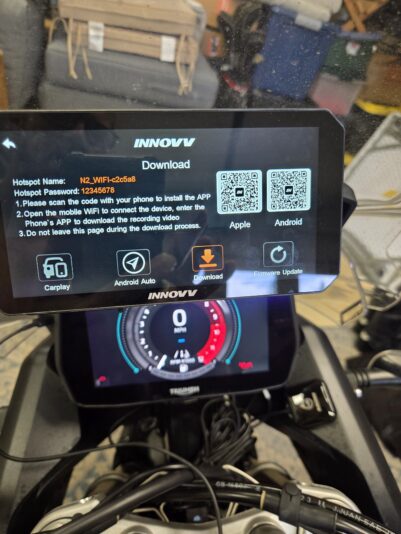

  • Charles
    2026-03-20 at 22:54
    When I get to the innovv download screen and hit download, nothing happens..

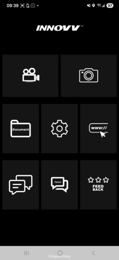

      Have you already tried downloading the videos using the Innovv app?
      Connect to the N2 and open the app.
      Select Document, Camera Files, Continuos Videos. Wait until the video thumbnails become visible. Click on a thumbnail and select download.

      Hi Jeff,
      To download the videos, use the app; see my previous message above. The N2 therefore does need a Wi-Fi connection to your phone.

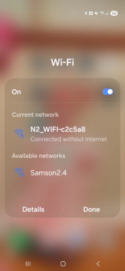

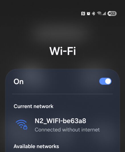

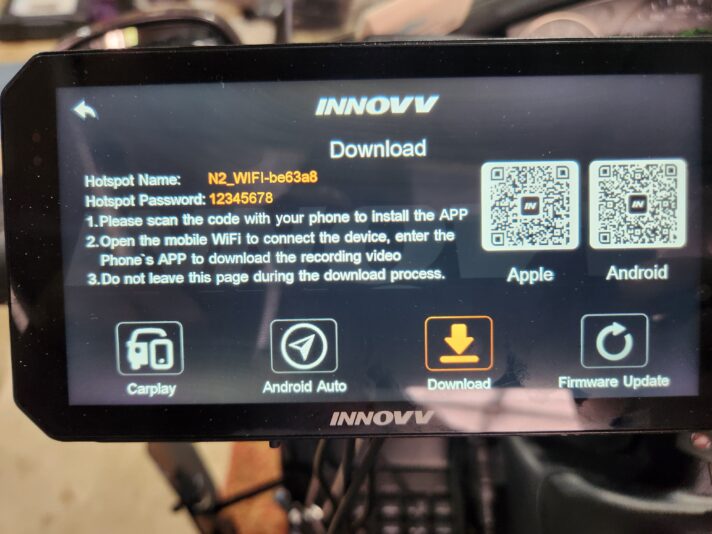

    I was able to resolve this issue. You have to reset unit to get to download screen. Realease all prior N2 Android connections & N2 bluetooth. Meaning you have to be at initial screen. You then have to connect to N2 without internet. No Android Auto. No N2 Bluetooth. Follow instructions in screen. It works but a very cumbersome process.

      2026-07-24 at 15:49
      Hi Jeff,
      Just to clarify, are you talking about downloading videos, not downloading the firmware?
      Can you show photos of what happens when you press the download button? For example, are you asked where you want to save the videos? What do you see happening in the app?
      And were you also able to download the videos in the app as I described earlier? With the N1 and N3 and other Innovv cameras, this is actually the easiest way to download the videos. You don’t have to disconnect or reset anything. The only thing you need to do is establish a Wi-Fi connection with your camera.
