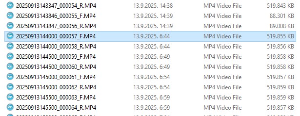

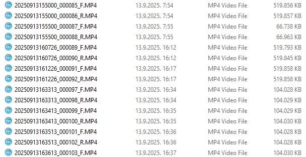

    The next thing is, sometimes the system changes the video timestamps on the files; the actual timestamp on the video is all right, but the timestamp on the file is several hours off and after several videos it corrects itself. Also, the date/time in filenames are correct, just the metadata (creation date/time) is messed up – see screenshots.

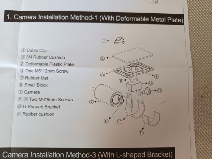

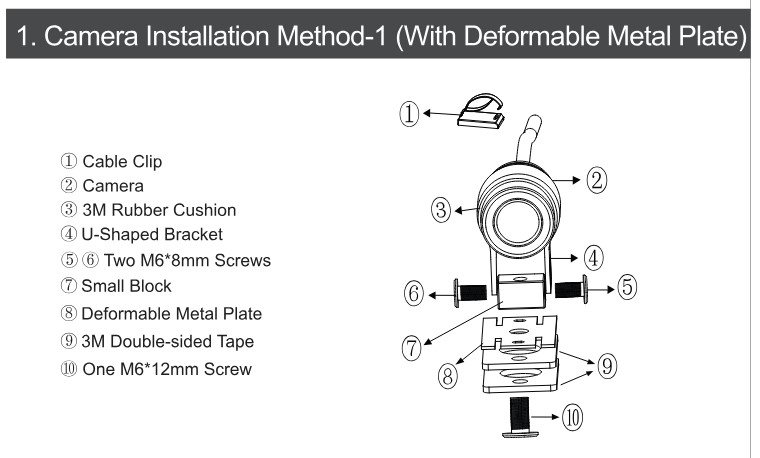

    Speaking of the manual, in the manual that came in the box there is a section about the mounting with the “deformable metal plate”, but there is no metal plate… you guys changed it for a plastic one; the text in the manual says plastic, but in the title is metal. See included screenshot from the manual online and picture from my manual. Might want to make a change in the print.

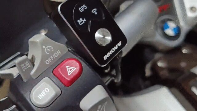

      Me again… after a couple of rides, I think I know why the unit did a factory reset (it happened several times during rides when I tried to screenshot). The remote unit seems to have a problem with button being stuck if pressed in a certain way. I’ve included the video. The intermittent issue with time metadata comes and goes. I reconnected the yellow wire to the rear light, so that wasn’t the issue. Can you please check and advise what to do? Or should I send an email directly to Innovv?

        This isn’t how the button is supposed to work. The button shouldn’t get stuck.

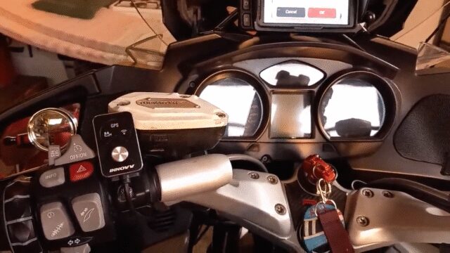

      I have spent some time playing with the system, and I think I can show when exactly (and why) the slow blink is occuring.
      See attached video; system starts up, begins recording automatically… all good. As soon I connect my (android) phone and open file browser, you can see the icon slow flashing. When I exit the app, the flashing stops and camera led returns to normal (on) state. Every time I enter the file browser on the app (or settings for that matter), the icon slow blinks every 2 seconds. You can also see the double click fail and success for the screenshot… I’ll stay away from screenshot, I’ll use the single press from now on (and later take the screenshot from the video).
