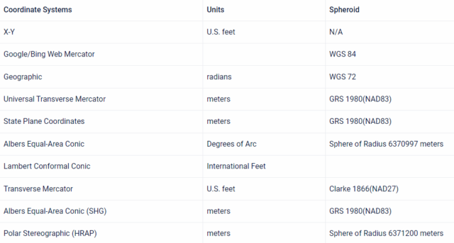

    The same coordinate can be written in different ways. Depending on which system you use, you will have to convert/recalculate a coordinate.
    You can assume that if you have placed your GPS receiver correctly, the measured position in the GPS signal can be quite accurate, within a few meters. But this also depends on various factors.
    • place of your GPS receiver on your motorcycle
    • is the GPS receiver placed horizontally?
    • many tall buildings around you
    • etc.
    https://www.wikihow.com/Write-Latitude-and-Longitude
