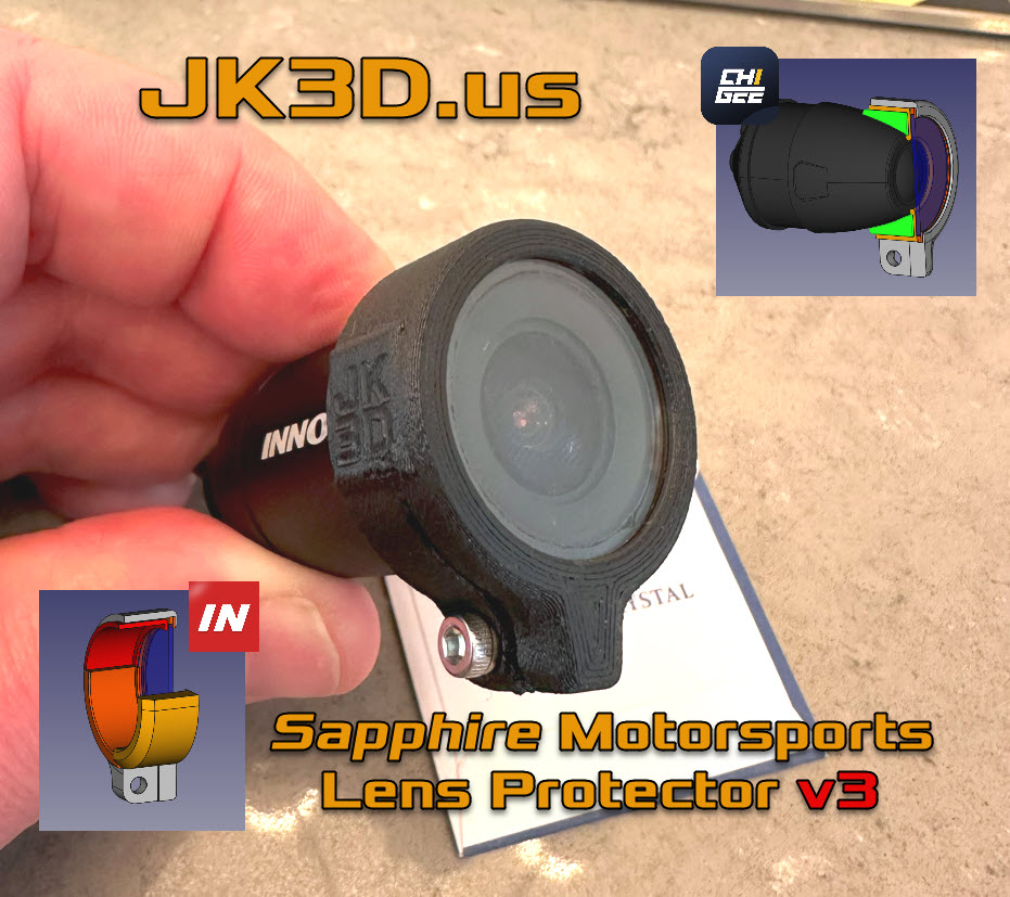

  • Joe
    2026-02-08 at 02:47
    There is a better lens protector here: https://jk3d.us/product/jk3d-motorsports-camera-lens-protector-v3/
    The OG for these cameras (been making and selling these since 2021 for INNOVV cameras). The INNOVV one is a nice cheap one, but mine have been used by hundreds of customers and few have had issues with fogging.
