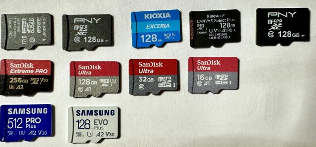

    K-5 camera hooked up to a new battery, starts up without a memory card there is a connection to the phone after inserting the memory card the camera does not start up, the camera LED flashes 12 times also lights up the GPS LED, Wi-fi and the cycle repeats. The wifi network on the phone does not start. A reboot of the camera was performed did not help. Tests were performed on 11 different memory cards. Camera with memory card does not start.
