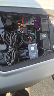

    Hi, I bought an Innovv K7 in September last year and installed it onto my BMW. I have never been able to get the system to work reliably ever since. After speaking to Innovv and trying different system setting and SD cards I was wondering if anyone on here had a similar issue?
    I don’t have the microphone or the remote control connected normally as I just want the system to record. Due to the issues I have been having I connected the remote control hoping it would provide some insight.
    The problem is when the bike is stationary with the ignition on the green LED on the remote is on solid and I can view both cameras via the app and everything looks good. When I start the bike and the engine is running after 10-30 seconds the green light changes to a slow flash (around once ever 2 seconds). According to Innovv this means a protected video is being recorded but when I access the files there is no protected video folder, I have the parking function turned off as well as the accelerometer and the G-sensor set at its lowest setting.
    Once I turn the bike off and restart the Innovv system the green light comes back on solid again and normal recording resumes. I have tested the power, ignition and earth connections and also bridged the ignition connection to rule out a wiring problem everything has tested OK.
    Can anyone shed some light on this?

    2026-06-24 at 01:29
    Hi Aaron,
    It is possible that the K7 wiring is picking up an interference signal from the engine wiring somewhere. This can happen if wiring runs parallel to engine wiring that carries more power when the engine is running. For example, wiring for the alternator, ignition, etc.
    It is also possible that if you have twisted the K7 wiring into a loop, it can act as an antenna and receive an interference signal from your engine.
    What is the battery voltage when the engine is idling? Is it too low? Or is there a large peak/dip in the voltage during starting?
    Perhaps you are able to power the K7 from a separate battery while leaving the K7 on your motorcycle. If the problem does not occur, you need to investigate the power supply to find the cause.

      2026-06-26 at 01:57
      Hi Hans,
      Thank you for getting back to me. So tonight I carried out as many checks and tests as I could. Which has resulted in me stripping down the motorbike and re-tracking the camera wiring to avoid any electrical interference and well as re-doing power wiring, testing the system using an external power supply, and trying a few more SD cards just to be double sure of everything.
      The conclusion of all these test are as follows:
      If I have one camera connected to the Innovv K7 system (doesn’t matter if it is the front or the rear camera) once I start the engine the green LED on the remote control stays solid and the camera can be viewed on the Innovv app. Everything seems to work correctly. I would need to take the bike for a test ride to check if this single camera setup works over a long period of time but it works longer than 5 minutes with the engine running.
      As soon as I connect a second camera (either the front or the rear camera) the green LED on remote starts to flash and both the camera views on the Innovv app goes black. With both cameras connected during engine start up the fault takes the usual 10-30 seconds to happen. If I connect the second camera with the engine running already the green LED starts blinking almost straight away.
      Have you any ideas what this could be?

        2026-06-26 at 16:04
        Hi Aaron,
        So it looks like one of the cameras is defective.
        If you swap both cameras one by one, front and back, and you can be certain that one of the cameras is defective, you might be able to claim it under warranty if the warranty period has not yet expired.

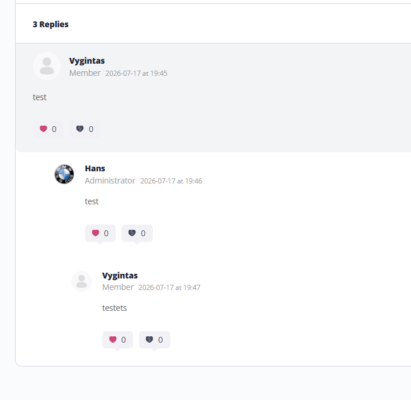

    Having the same issue, happens two or three days ago. Forum does not work (I can not replay or post anything if it is long writing), after sales support does not work,sends me email to do the same what I have sent them I did.
    • This reply was modified 4 months ago by  Vygintas.
      2026-07-17 at 19:52
      Hi Vygintas,
      Can you describe what you have already done to resolve the problem? That way, fellow forum members can help brainstorm a solution. For now, it is a guess to us what you have done.
      The more info, the better we can help.
      Regarding your forum post problem: I just logged in under your account and can post an answer and a reply without any issues. Could you try again? And if it doesn’t work, could you tell me what steps you take to post a reply?
      • Vygintas
        2026-07-17 at 19:59
        Still can not post anything longer than this text. Hans I have send full text I wanted to post on forum via messages.
