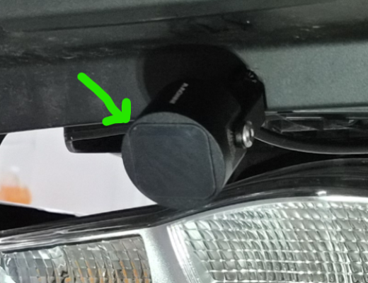

    Did you aim the radar higher? Because in the photo I see that it is pointing quite a bit downwards. I aimed it almost straight back and this works very well. See also my photos under my profile page.

      In the final result, the sensor is horizontal or a few degrees down. Works great on the road.
      One quick question; does the sensor have a plastic cover that needs to be removed? The Mirror LEDs have a cover and the sensor appears to but I don’t want to damage it if it does not.

        On my unit, there was a very thin plastic protective film on the radar unit. This could be easily pulled off. This film was only on the radar itself, so the square part. I suspect yours still has it on. In the photo, it looks like there is a bit of air under the protective film in the top left.
        • Jeff
          2026-07-07 at 18:57
          You were correct. Thanks!
