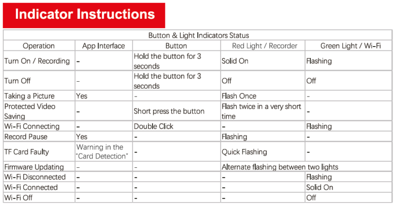

    The half-red light/green flashing light, according to the manual, means that recording has started but that there is no active Wi-Fi connection. Regarding the app:
