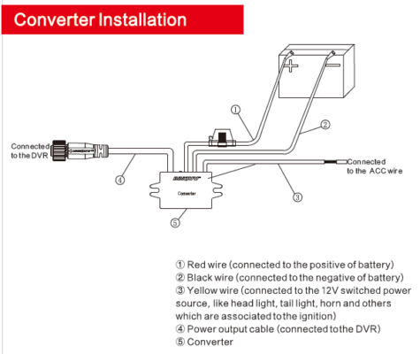

    I am installing my K3 into a new bike and this has a Thunderbox – I’ve connected the red and back wires to that, but it’s not working – presumably because I need to connect the yellow wire somewhere – where would that be?

    Hi Martin,
    The red and black wires must be connected to a continuous power. The yellow wire must be connected to an ignition-switched power supply. For the ignition-switched power supply, you can use, for example, your license plate lighting if it is always on when the ignition is on.
