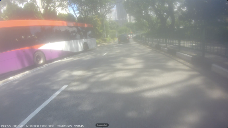

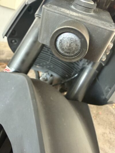

    have a set of the k5,
    suspect dust got into the lens
    any idea if the unit can be opened and lens cleaned ?

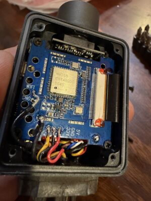

  • Frostie
    2026-06-01 at 15:06

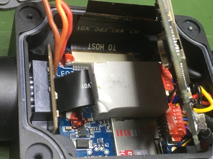

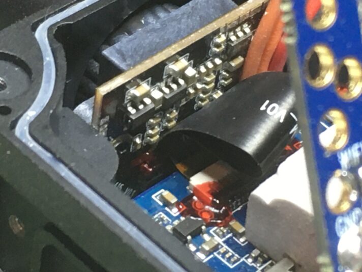

    Are you sure it is dust and not moisture? I can’t see how dust could enter the lens by an open sd card slot.
    Removing the lens will not be an easy job, but if you want to try, you could flip back the top board by disconnecting the flat ribbon cable. For this you need to remove the red coating and push the holders to the side. With the four screws removed you can then flip back the board.
    I myself have not gone farther than that. But to remove the lens, you would now need to remove the flat ribbon cable of the lens. Maybe it is possible to flip the lower board after unscrewing it. If not, you would need to disconnect the secured connector in the back first.
    The boards need to be removed to reach the screws of the lens and to get enough space to pull the lens out. But I don’t know whether it is glued in or sealed in any way.
    Oh…ignore the three (brown, orange, red) cables at the left in the picture. They are from a modification I made and originally not there.
    Greets,
    Marc
  • mingsect
    2026-06-01 at 15:58
    you’re right , could be moisture too..
    thanks for the pics,, look like an impossible task for me to diy
    with so much boards packed back to back,, most prob, im better of buying a new front camera.

  • Frostie
    2026-06-01 at 16:50
    Replacing the front cam of the K5 also means replacing the DVR, as both are combined in one case. Or in other words….you would buy a new K5. So “repairing” the K5 may be worth trying if you plan to buy a new one anyway.
    But before that I would check if it is moisture. You could put the DVR in an oven and let it run at 50-60°C for a while. This could remove the moisture in the lens.
