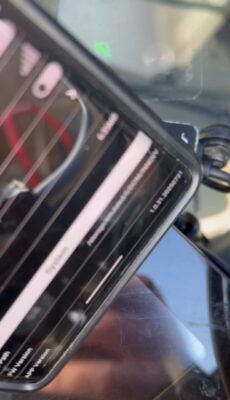

    Hi looking for some assistance.
    My 10mth old K5 has started to not work correctly.
    (see video)
    I’ve reloaded the firmware multiple times, it responds and reset with the control button hold.
    When powered on it will do as in the video,
    – it wont attempt GPS sync
    – the videos it does record are short 20/30 seconds on start up only
    – both cameras provide a feed
    – WiFi maybe come on for a few minutes, the control panel has a 50/50 chance of working
    – Same when powered by the bike or a battery
    – Memory card is fine (also reformated)
    – Firmwares take can see the version change in the control panel… if I get in
    (the one in the video i thought i’d show as the version string never shown)
    Also wondering if there is an older firmware I could ‘roll it back’ to to see if that worked.
    Any help would be great, I only got it in July last year and was hoping to get a good use out of it soon
    2:28
    Messenger_creation_C0836353-C915-46A1-AD4A-392C599AEC0E
    2:28
