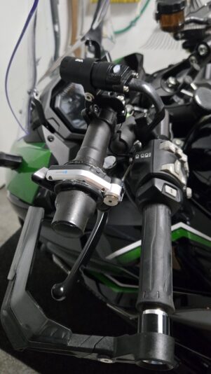

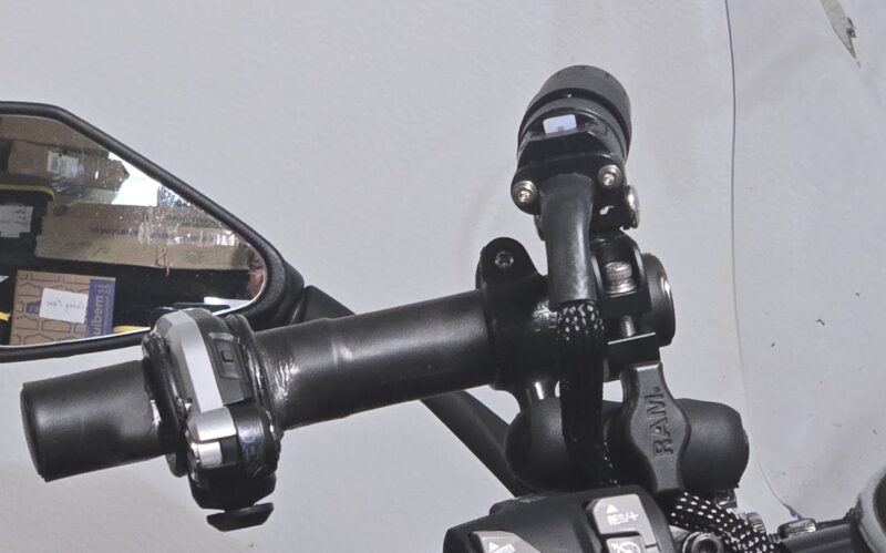

      Hans, Happy to report that the camera is installed and operational. I appreciate your help with the details. As it turns out, the system works well with the PDM60. The important detail is to insure that the yellow wire connects to the Ignition switch line on the PDM vs. the Ground switch line. Dooooh! 😊
      Again thanks for your assistance and safe riding!

    Thanks for the feedback and the pictures.
    Have fun with your K6.
