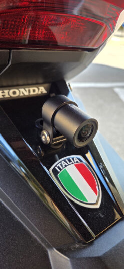

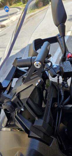

  • Nicholas
    2026-03-26 at 17:16
    Hello to all, just to close the loop and show you the camera(s) installed
      2026-03-26 at 18:07
      Thanks for sharing the photos.
      Your K6 front camera is now also well protected against the rain.
      Are you not bothered by reflections from the screen?
      • Nicholas
        2026-03-26 at 18:49
        Hi Hans,
        actually it is a good point. I did not really checked footage where the sun reflection can be an issue. (at night the result is quote good and clear).
        My main issue why I decided to install it there is for easy access in case I need (remove the SD card,etc. since the other option was between the 2 front light, underneath the fairings but I found it too exposed and not so easy to access in case of need.
