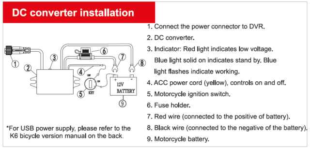

    If you have installed the K6 on motorcycle, you should be using the supplied power converter. This way the camera will start and stop recording with the ignition switch.
    The Red cable needs to wired to be a permanent Live. The Black cable needs to be wired to a permanent Earth. The Yellow cable needs to be wired to a Switched Live.

    2026-08-17 at 00:34
    Hi Simon,
    The USB version is intended to be connected via a power bank or something similar. So, for example, when mounting it on a bicycle.
    With a USB power supply, the K6 does not start up automatically. After all, there is no switched power supply present to serve as a trigger for startup.
    When mounting it on a motorcycle, you can use the DC converter to connect the power supply. With this DC converter, the K6 does start up automatically if the DC converter is connected, as clearly stated in the user manual.

      My bike works exactly as my motorbike. When I switch it on, the USB powers up. Very normal. The camera just fails to start.
      That converter you are showing cannot be used for my camera. I do not have a plug for the 3-pin connector(1). Only a plug for rear camera, and a USB-C plug.

        2026-08-17 at 22:19
        Hi Simon,
        I am one of those users who uses it with a power bank. Additionally, I also use one with a DC converter in my car.
        The fact that you have to turn on the K6 manually with a USB version is also a reminder that you must turn it off manually as well. Because if you remove the power supply before the K6 is turned off, the last recording running might become corrupted and unplayable. The SD card could also become defective as a result. Think of the K6 as a small computer; you also have to shut it down properly before removing the power. The DC converter takes these actions off your hands. That is to say: ignition on, K6 starts automatically. Ignition off. The recording running is terminated correctly, after which the K6 is switched off properly.
