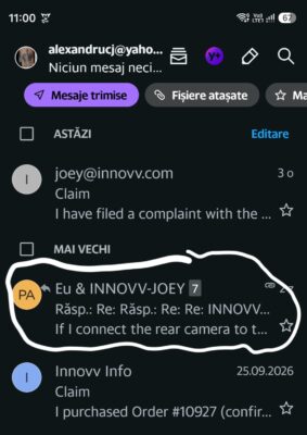

    2026-10-03 at 14:24

    We are sorry for the inconvenience caused to you.
    We replied to your email on October 1, but it appears you did not receive it.
    Original email text:
    We didn’t immediately conclude that the connector was faulty.
    We need to troubleshoot step by step to determine whether the problem is caused by the camera or the DVR before we can arrange repair or replacement.
    If you don’t want to send it back for repair, we will ship a DVR and a rear camera to your order address. Is that okay?
    Is the rear camera 1 meter or 1.5 meters?
    Looking forward to your reply.
    Have a good day!
