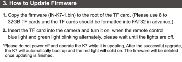

    If I understand correctly, you think an app is required to put the new firmware file on the SD card,
    No app is required for the copy. Just use your PC to copy the firmware. Put the resultant SD card rd in the K7 and power it up.
    The K7 knows to go into firmware update mode when it finds the file at power up.if there is no firmware file it just does a normal startup.

    See also the user manual.
    Please ensure that you use an SD card no larger than 32GB and formatted as FAT32.
