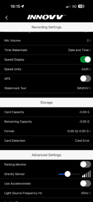

    I am having similar problems, got the SD card (Samsung 512GB EVO Plus UHS-I microSDXC Memory) supplied with the K7. Was working OK, then took it out to view on Windows 11, but its not worked since. I have tried formatting in the device, but it wont work. Its only been in the bike for two months. I can get other cards to work, but the 512 wont work in the K7, formatting in the K7 gives an error. The card remains with its contents intact as it still has the video clips from first use. I hasn’t been recording to SD for the last two rides, only discovered when I went to check after a car pulled out on me. I have the latest firmware as of this weekend.
    • This reply was modified 6 months, 1 week ago by  Nic.
      2026-04-23 at 01:43
      Hi Nic,
      The K7 is compatible with 512GB SD cards, so the problem is not with the size of the SD card.
      By ‘formatting in the device’, I assume you mean the K7. When you put the SD card back in, is it seated correctly in the slot? Since other cards do function in the K7, you can assume that the SD card in question has become defective.
      You could perhaps look for a program that performs a deeper format on the SD card and might be able to repair it. However, I personally wouldn’t trust the SD card anymore.
