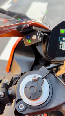

    Hello, I want to add my same experience with k7. I have a R1200 RT my 2010. Connected k7 as manual suggest, first run seems that work all fine. Gps took a while to find the fix (first cold fix?)
    Today green light (camera) started to blink slowly for a good part of the route. I still have to check if all the route was recorded, but I noticed the same light behavior.

      Hi Davide,
      A slowly flashing green LED can indicate that a protected video is being recorded. This can happen, for example, if the G-sensor is set too sensitive and is therefore triggered by shocks or vibrations while driving.
      Recordings can then be found in the ‘protected’ video folder.
      See also the manual for an explanation of the LEDs on the remote control.

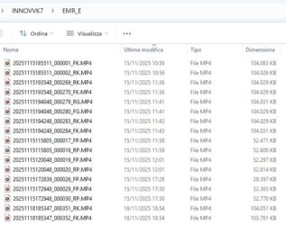

        After a check, I can confirm that many videos (1 minute clip) are missing, could be a coincidence but the video storing missing coincide with the green light slow blinking (This issue coincide with k5 manual indication)
        In the microsd I found 2 subdirectories (movie_E and EMR_E)

    tl’dr: seems the K7 has problems with at least some >128GB cards.
    After switching the SD Card from a 512GB TCELL to a SanDisk Max Endurance 128GB (both rated at V30/U3), and with recording interval set to 1 minute, I’m getting mostly reliable recording now. The dashcam doesn’t crash, but does skip 5-10s about once an hour or so.
    I have made a few >1 hour long trips with the 128GB card and have had zero instances of the dascham ceasing to function. There are still instances where the camera glitches and skips about 5-10s at the end of a recording, this happens to about 1 in 100 recordings (about the same rate as with the 512GB card). I don’t see any pattern to the skips, other than it’s always ~5-10s missing at the end of a one-minute file. That’s not ideal, but at least it doesn’t stop completely.
    Here’s one example where a video skip occurred (notice one pair of files is shorter than the others):
    https://drive.google.com/drive/folders/1SgrwdAciAwDCNdZfFSj_PR_iPi54kF_O?usp=sharing

    2026-01-07 at 18:26
    Hi Ben,
    I’ve looked at your video files. I see that sometimes no seconds are missing, and other times a few seconds are missing.
    Perhaps the K7 needs a little more time to free up space on the SD card when writing files if it’s full? To write a new file, an old file must first be deleted (first-in-first-out). This could be the cause of the missing seconds. To rule this out you could test with a full and an empty SD card
    • Ben
      2026-01-09 at 18:04
      The missing seconds issue occurs regardless of card free space; the videos above were with the card just over half full after a reformat via the K7 app. The file sequence number gives it away: ~760 files x 102MB ea. = 78GB, on a 128GB card. The hiccup had occurred multiple times earlier in the ride too, after only a couple of hundred files.
      It is true that an SDCard;’s sustained performance can vary as the card does its own internal wear levelling/etc, however this is the nature of the beast and the sort of thing that any dashcam would need to allow for.
      I’m in touch with Innov’s support on this, if anything comes to light through that I’ll endeavour to update this thread.

  • Tarick
    2026-01-15 at 12:44
    For folks wondering what the remote looks like when the K7 is crashing/rebooting and stops recording video, this is it.
    It used to happen to me all the time before upgrading to firmware IK7.20250317.V05. Since then it’s only happened once. I’m using a SanDisk 512 GB “high endurance” microSD card (SDSQQNR-512G-GN6IA).
    0:13
    IMG_7099
    0:13
      2026-01-15 at 16:53
      Hi Tarick,
      Is this reboot happening randomly? It can’t be traced back to, for example, a dip in the power supply or a loose connector. It also doesn’t happen if the SD card is full?
      • Tarick
        2026-01-15 at 23:15
        I haven’t observed a pattern to it. Cabling isn’t loose (I’ve checked several times). The latest firmware seems to have fixed it though.
