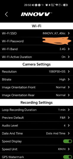

    Here I am again.
    My K7 ha this issue.
    After a certain time (typically about 10 minutes. My K7 stop recording. I can note this by the camera icon start flashing slowly (the owner manual tell a different instruction).

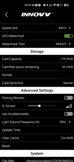

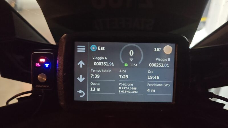

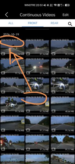

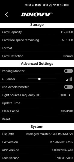

    The MicroSD is Samsung and formatted with K7, the camera are firmly fixed. In this example the k7 started recording at 18:35:36 and stopped at 18:45:46 the second picture show when the bike was turned off (19:46), so k7 missed to record about 1 hour. I added also the screen of the configuration. Some suggestions?

    2026-10-19 at 22:07
    Hi Davide,
    The camera LED flashing slowly can also indicate that a “protected” video is being recorded. These are saved in a different folder—not in the “Continuous Videos” folder. Please check the other folders to see if they are there. It is possible that the G-sensor sensitivity is set too high.
    When you turn off your motorcycle, you are stationary, so the G-sensor is not triggered; consequently, this final recording ends up in the “Continuous Videos” folder.
    If you are still unsure, you could also try the option that Robert mentioned.
