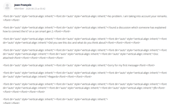

      PS, could you please take another look at how you post messages? Due to the many formatting characters, it is almost unreadable.
      See the attachment to see what your message looks like.
