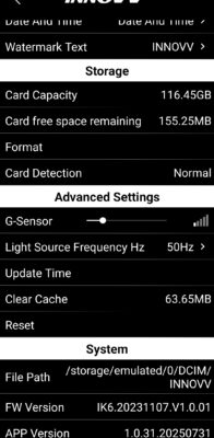

    Hi Nicholas,
    Does your SD card meet the specs set by Innovv? Write speed higher than U3.
    Have you also formatted the SD card using the Innovv app? It is also recommended to format it after reading it on your PC.
    I see that sometimes multiple recordings are made in a short time, e.g. June 22 16:25, while I believe your run time is set to 5 minutes. I suspect the problem lies with your SD card.
    Do you have the possibility to test with another SD card?
    To be sure, you can also flash the (latest) firmware.

    Hello Hans,
    Thanks for your fast reply. I just formatted the card using your app and installed the latest firmware.
    For you info, the card is a brand new 128Gb.
    Let see how it goes. 😀
