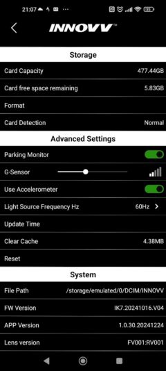

    I have a similar problem. According to the LED on the control panel, the entire unit restarts. The problem only occurs when the SD card is full. After formatting the SD card, everything works as it should. The problem will probably be at the moment when the recordings are supposed to start being overwritten. I can tell by the fact that the WIFI LED is flashing, which should turn off after the first 5 minutes according to my settings.
    Well, today I found out that sometimes 1-2 minutes of recordings are missing, which are not saved anywhere. I tried installing the latest software, which I thought would fix the problem as described, but it still seems to crash occasionally. (As a temporary solution, I copied the contents of the card to my PC today and formatted the SD card)
    SD card:
    Samsung 512GB EVO Plus microSDXC A2 V30
    Firmware: 20241016.V04

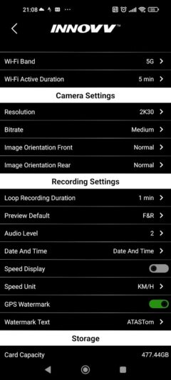

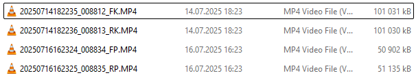

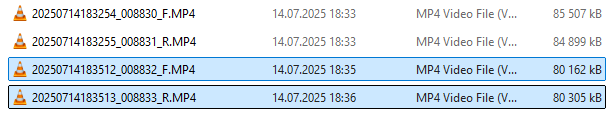

        I tried to format the SD card with the app as recommended and now when the card is full again it happens again. I’m not sure we got it right, so I’ll try to describe my problem better.
        1. I start the bike and the camera is on, loop recording normally works. (GPS-orange, REC-green and after five minutes the wifi is automatically switched off)
        2. Now I’ve been paying more attention to it and while driving I noticed that all the lights are off and then the REC starts flashing green and later the GPS light comes on and the WIFI light is flashing again.
        So from this I’m guessing that the unit has rebooted. And after that the recording it’s running again for some time. This only happens if the SD card is full, until then everything works as it should. I also send a screenshot from the directories where the videos are stored and you can see that 2 minutes of the recording is missing (I can also send the videos themselves to a private email, where you can see that I am driving and suddenly I am in front of the garage ). The second picture is as proof that the accident was not recorded, it was 10 min. earlier. I also include a screenshot of the settings, if I have everything right 😀.
        Of course, as workaroung I can format the SD card and then everything will go back to normal. But it’s quite annoying to check if the card is already full ,because I’ve already had one moment where the camera didn’t work when I needed it. Luckily, nothing happened, so this footage would only serve as proof of what an ***** the driver was.

      From my point of view, removing the vibration does not solve my problem, because when checking the recording from this weekend, I have the entire offroad part recorded and the problem appeared when driving on a smooth road. I changed the time to 3 min for the loopback recording, which helped and from the entire 9h ride I am only missing 4 minutes = the unit restarted only 2 times. And if I format the entire SD card and everything works without problems, then this also indicates that the vibrations are not my problem.
