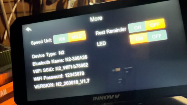

    UPDATE: I remembered how to do the OTA update, and I’m up to v1.7 now.
    NEW problem: The option to toggle the flashing LEDs no longer works. I can go to the settings page, and easily flip the settings between MPH/KPH, and also I can turn the “Rest Reminder” on and off, but the “LED” setting does absolutely NOT work anymore.

      2026-07-01 at 00:22
      Hi Charles,
      Is the touchscreen not damaged at the switch location?
      Perhaps you could test this spot on the touchscreen with a different setting/function on the N2?

        2026-07-01 at 02:26
        Screen is not damaged, trust me. Works just fine in carplay to select icons and is generally functional. It’s only this button which no longer works.
        I’ve already opened a ticket with support. They’ve responded and are looking into it.

        2026-08-24 at 23:22
        Turns out: While firmware v1.7 broke the LED option, if you apply the OTA firmware update v1.7 which exists NOW, the issue is repaired.
        Like a sucker, I’ve been assuming that with an error in v1.7, the update/fix would be in a file with a newer version number. Not so!
        Once I remembered how to do over-the-air updates (key: turn off Bluetooth on your phone so it doesn’t automatically connect, and then the LINK button goes to a menu which contains the update option), I re-installed v1.7 and the option to toggle the LEDs on/off once again works.
