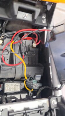

    How did you connect the power supply? Are the red and black wires continuously powered, and is the N2 switched by the yellow wire?
    Are you using a Thunderbox, HexEzcan, or something similar to power the N2?
  • Charles
    2026-01-08 at 09:18
    Red and black to the battery terminals, yellow to a acc switched circuit…. I would assume the red wire to the positive post would keep continuous power to the unit keeping the clock on even when the yellow wire goes off and shuts down the unit…Does the unit have an internal battery that needs to be charged via the usb-c port on the bottom?

    The N2 will likely have a backup battery in case of a power outage. This is maintained by the continuous power supply on the red wire. Since the N2 cannot be disconnected, it wouldn’t make sense for the internal battery to still need to be charged via USB.
    Could there be a significant voltage drop on the red wire when you start the engine? And could this reset the N2 clock?
    What happens if you disconnect the yellow wire with the engine running and then reconnect it? So, with the engine running, shut down the N2 and restart it. Is the clock still reset then?

    So with the bike running, I have 14 volts. Set the time and date, then pull the yellow wire. Wait 10 seconds, plug it back in… bike is running the whole time.. Display comes up, then 2 or the seconds later, the accurate time resets to 0000…. included a 22 second video…….
