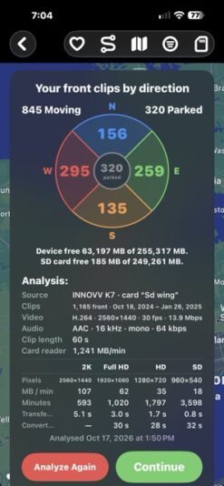

    You place the micro SD card into a USB-C adapter and plug it into your phone. Then you tap Video “Analyze/Create Videos”. The option opens to a technical analysis of the contents. It counts your clips by the direction you were moving in or were stopped. It reveals the technical specs for video and audio. Then it shows how much room you have on your phone for each of 4 resolutions from SD to 2K. And how long it takes to transfer or create new videos.

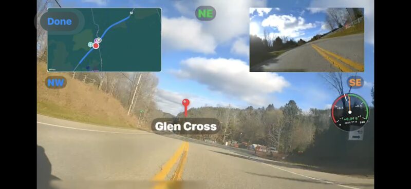

    This is followed by a map displaying the location of every clip on the card as a coloured direction arrow. Zoom in or double tap an empty area to select a specific clip. You are prompted to choose the length of clip(s) you want to work with from that point onwards, 1, 5, 10, 20 minutes or the rest of the ride. A ride is terminated by a minutes value you control. You can Mae any clip a “favourite” and later filter the clips displayed to only that ride or within 10 minutes of that clip.
    The selected clip then starts to play. You can choose front, rear or both in either over/under or side by side or picture in picture. As you watch, your current position always appears on the map showing your saved waypoints. When the time elapses, you can then choose to see more time or you can choose to see all clips in sequence by date and time.
    While viewing, you can turn on/off a text display of the current speed, g forces and lean angles. A graphic G meter with built in speedometer can be viewed and it rotates right-left as you run a corner to emulate your bike.

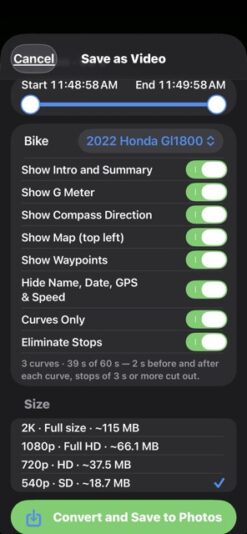

    Select the download symbol at any time during play and you manipulate a series of settings for a new video you will create: The date and time to start and end. Show an Intro screen summarizing the ride. Show G Meter. Show compass directions. Show the map. Show waypoints. Hide the burned in data un the lower left. Show curves only… drop boring straight sections. Eliminate stops, even more boring. Then select the resolution of your new video. 2K, Full hd 1080P, hd 720P, or 540P SD.
    Then press “Convert and save to Photos. Thumbnails display for each second of the new file and a progress bar tracks progress.
    When your video is ready you can view it, or delete and try again with different settings, email or text it to anyone.
