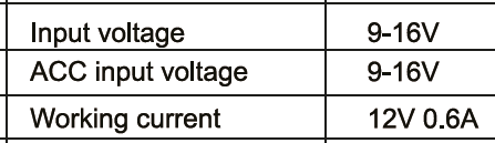

    In the manual, you can see in the specifications that the working current can be 0.6A. So if you measure 0.5A, this could be correct.
