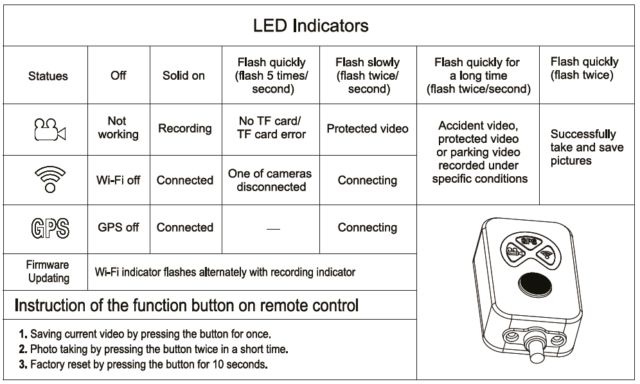

    I see lots of frustration around taking a picture. I find it hard to do it too. More often than not, I set the light to flashing. It would be nice to 1) make the 2nd option a press and hold [.5? 1s?] and 2) Make them swappable so that “Snap a pic” is a regular press and “Protect Video” is a long press.

    I don’t understand what you mean by ‘I set the light to flashing’. Have you read the manual for the remote control? It explains how to take a photo and how to secure a video. Video files are automatically overwritten when the SD card is full and you have selected a time under ‘Loop Recording Duration’. The files are overwritten based on FIFO (First in, first out). This means the oldest recording is overwritten to make room for a new recording. If no time is set for Loop Duration Recording, it is possible that you will receive recordings of 12 minutes. When the SD card is full, no new recordings will be saved.
    You can delete a protected recording by formatting the SD card using the Innovv app. Alternatively, you can insert the SD card into your computer and delete the files that way.

      I’ve been through the Manual (mine is misprinted vs what you attached above). When I double press the button, more often than not, The Movie LED flashes constantly. I’m either pressing it too quick or too slow.
      Is there a way to turn off Protected Video if it has been activated by a miss-double press button to take a photo? When does it stop being protected?

    It might take some practice with the button to figure out how fast you need to press it. Also, keep in mind that with motorcycle gloves on, it is not always easy to feel if you have pressed the button.

    Note that when you make a protected recording, only the current recording is protected. So, if you press the button to protect just in the last second of a current recording, the next recording will no longer be recorded as a protected video.
    It is not possible to remove the protection from a recorded video that has been saved as a protected video.
