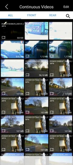

    2026-03-19 at 03:12
    Photo blackscreen is when i push the button. I see a red recording dot. I see a pause button at the bottom. The other photo is the documents map with the continued recordings.
