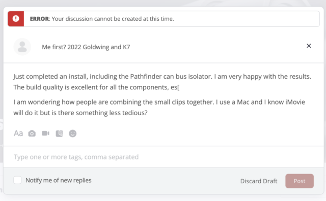

        Hans, the new K7 forum is failing to allow new posts.
        Are you an Administrator for it as well?
