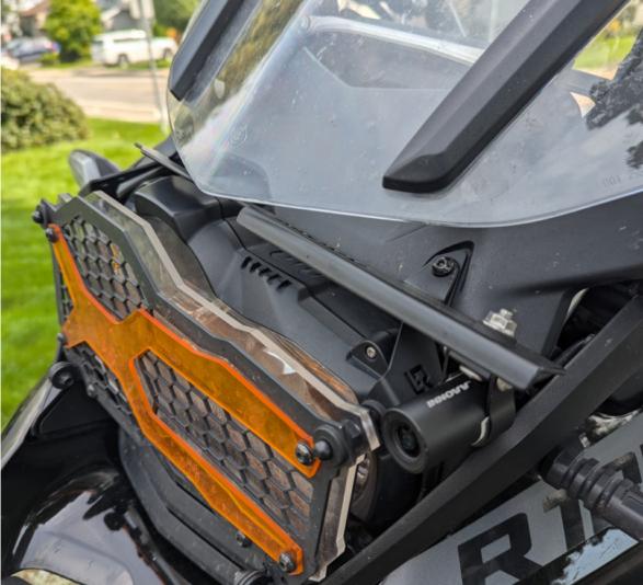

    – FRONT CAM : My R1250GSA already had some special bracket (LoneRider HeadLamp protection) but I was able to put both bracket on top of eachother. Now, My Windshield can’t go as low as before, but it’s ok it does go down low enough
    Note : tape arround the front cam is not permently applied (white lol) in the pict, still testing…

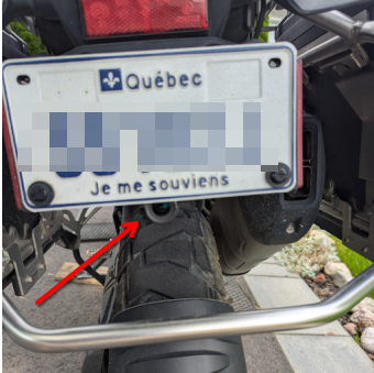

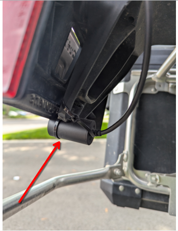

    – Rear Cam : my North American R2150GSA 2021 had some perfect spot under the plastic holding the number plate. Some curved hole. I placed the Back Cam there with some 3M ( Alien Tape) and 2 TiedWrap. One to secure it the other to change the angle a bit so the Cam doesn’t show the bottom on the number plate.

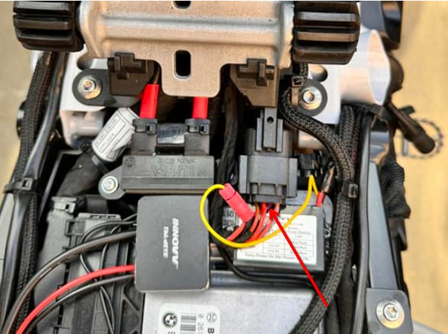

    – I used the DIN socket wire for my yellow wire (accessory) but it seem I could have use the one you see in the pict ( in front). Easier to Posi-Tap this one…. CHeck to be sure to use the right one…

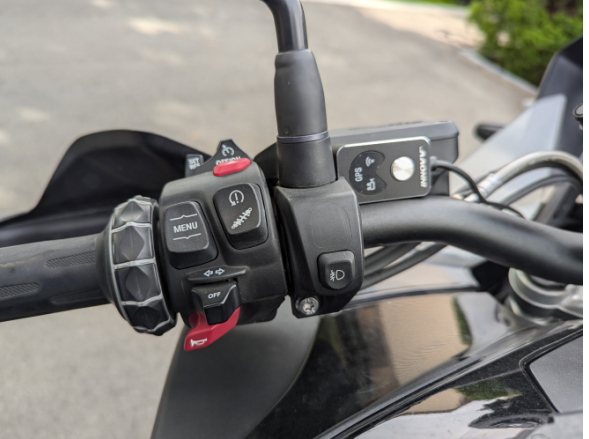

    – decided to pu my remote there. Easy to reach. Some put it on the pole holding the mirror but I prefered it there.

    THE PICT showing a possible accessory cable to tap-in for you yellow wire is not from me… MY DVR is in the Sargent seat compartiment and I posi-tap to the DIN SOCKET wire
