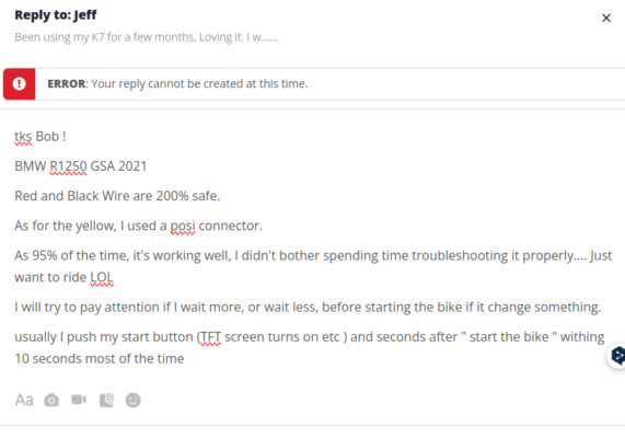

  • yoda
    2024-10-25 at 20:46
    see pict
  • yoda
    2024-10-25 at 21:48
    I just installed 2024-10-16 firmware.
    We’ll see if the problem comes back
