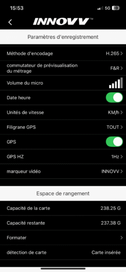

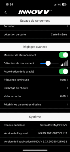

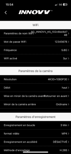

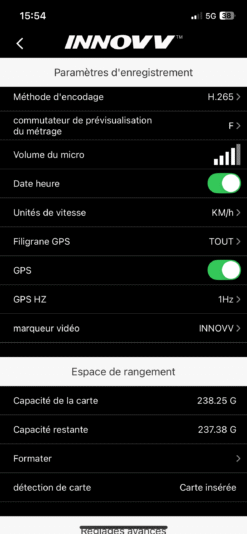

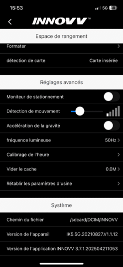

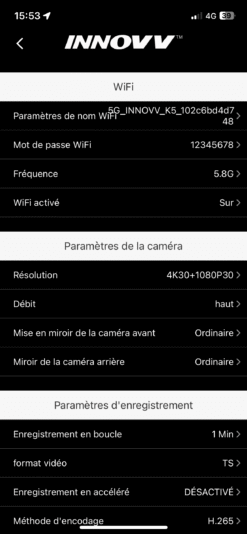

    2025-07-17 at 22:26
    Hello,
    I just received my rear
    camera from China for the INNOVV K5 system.
    It works very
    well…phew.
    However, I can’t save the settings in the INNOVV app
    on my iPhone 12 (French version).
    I change the TS option to MP4,
    but it doesn’t save. When I turn off my motorcycle’s engine and
    restart it, my iPhone’s settings return to default, i.e., in TS
    mode.
    I deleted and reinstalled the INNOVV app as well as the
    Wi-Fi on my iPhone.
    I formatted the SD card with the INNOVV app
    and performed a factory reset of the app.
    I put the latest
    firmware back on the SD card.
    The SD card has been changed (it’s a
    SanDisk Extreme 256Gb V30 A1).
    Can you please tell me where the
    INNOVV app settings for the cameras are saved?
    Default
    settings:
    Front camera mirroring: Normal
    Loop recording: 1
    minute
    Video format: TS
    Parking monitor: OFF
    Gravity
    acceleration OFF
    Settings:
    Front camera mirroring: Flip
    forward
    Loop recording: 3 minutes
    Video format: MP4
    Parking
    monitor: ON
    Gravity acceleration ON
    (This setting does not
    persist, so the recorded videos are in TS and reversed)
    Can
    you please tell me where the INNOVV camera app settings are
    saved?
    Thank you in advance for your help.
    Michel

    2025-07-18 at 01:29
    Hi Michel,
    Good to hear that the rear camera is working for you.
    The app settings are stored in the K5. Every time you access the app’s settings, they are read from the K5.
    iPhones sometimes have a tendency to not establish a good Wi-Fi connection. If so, put your iPhone in airplane mode and then manually connect to the K5. Do you also have a VPN server running on your iPhone? If so, disable it as well.
    Perhaps this is the reason why the K5 does not adopt the settings properly.
