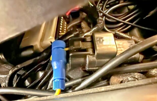

    Someone sent me this photo connecting to a yellow wire which is the live feed to the rear light. My question is, is the rear light wire live permanently or only only when the ignition is on, which if it isn’t then wiring it through the thunderbox should work.

    The yellow wire should NOT be connected to a constant power supply, but to a switched power supply.
    Rear light:
    You can check this yourself; your rear light should not turn on when the ignition is off. Otherwise, your battery would drain quickly.
    Parking mode:
    This function must be enabled with the app.
    If the power supply voltage is insufficient, this function will automatically be disabled to save the battery.
    The sensitivity of parking mode depends on how hard and fast the bike is moved. A firm tap will have a greater effect than a push. This also depends on the direction of the tap and where the DVR is mounted on the bike.
