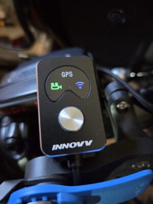

    Hey all. I’m brand new to this K5. Install 90%, I just have to tuck in the wires if it all checks out.
    2018 HD Street Glide Special. Steady blue when I turn the ignition on, then after a bit, steady red. Steady red when I turn it off, then the camera indicator blinks fast and the GPS comes on, then off. Light goes back to steady blue. Nothing on the wifi. I didn’t connect the yellow wire, is that required? SD card installed. I also can’t get the app to connect to my starlink internet. Ugh.

    Thanks Hans. Now, the panel camera and wifi indicators are lit. How do I get the wifi to flash?

    The Wi-Fi LED will blink if:
    • the rear camera is disconnected (so this is not a normal situation)
    • the Wi-Fi connection between the phone and the K5 is broken.
    So if the Wi-Fi LED is lit continuously, there is an active Wi-Fi connection between your phone and the K5. It is up to you whether you want to keep this active or not. In principle, you only need the Wi-Fi connection if you want to change settings in the K5 or if you want to download videos from the K5 to your phone.

      2026-04-27 at 05:56
      I never connected it to my phone, as I never saw the K5 network show up as available. I’ll keep plugging along. Thanks.
