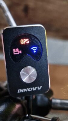

    Hi!
    I’m at my wits end – Can’t get this thing to video!
    I had the unit professionally installed by a Harley Dealership as I’m not an electrical wiz kid
    I have a 512GB Micro SD card – U3 https://www.amazon.co.uk/dp/B0DSVTSTY4?ref=ppx_yo2ov_dt_b_fed_asin_title&th=1
    I have flashed the unit with today’s K7 firmware – IN-K7-1.BIN
    The green video light constantly slow flashes (about 2 seconds) when I power up the unit – Video here & attached: https://youtube.com/shorts/klZBxTosmTc?feature=share
    When I connect the app (Android) the live videos feed is blank and nothing recorded on the unit in the Document section
    I have reformatted the card with the app – 3 times now
    I have reset the device from within the app
    I have turned off the G-Sensor
    I have checked all the cables to ensure they are not loose, all seem connected OK
    I have wiggled the control button to make sure it is not stuck in
    Just once, for a few minutes though, it DID WORK, then stopped again!
    I haven’t even ridden the bike yet with it working, just trying to get it to record while in my garage.
    Very frustrated
    Please help 🆘

    Hi Mark,
    The flashing blue LED indicates that there is no Wi-Fi connection. Without a Wi-Fi connection, you cannot watch or download videos.
    The slowly flashing green LED means that a protected/accident/parking video is being saved. This is not saved in the standard folder, but in a special folder. Check if the recordings are there.
    A protected video is saved when the button on the remote control is pressed. It’s possible that the remote control is defective, causing a video to be constantly protected.

    Hi Mark,
    The K7 supports cards up to 512GB.
    The K7 is not sensitive to CANbus communication. An isolator is therefore not necessary. Try to determine where the (switched) power supplies are connected.
    If you insert the SD card into a computer, can you see if anything is being saved to the SD card at all? Also, check the contents of all folders on the SD card.
    Moving the DVR can be seen as a trigger for parking mode or accident recording. Parking mode recording or accident recoding also produces a slowly flashing green LED.

      2025-10-22 at 02:12
      Hi Hans
      I posted the link to the TF Card I ordered from Amazon. The forum software decided it was ‘Kindle’, not me.
      I moved the DVR when the kit was off, obviously.
      There is nothing on the card as the device is not recording, in any folder, anywhere.
      I’ve given up with the thing! I paid a professional technician to install the hardware and it’s faulty so now I have triggered a return with Amazon and spent my evening trying to remove all the professionally wired and embedded cabling and devices. Needless to say I am not happy and have wasted money getting it installed.
