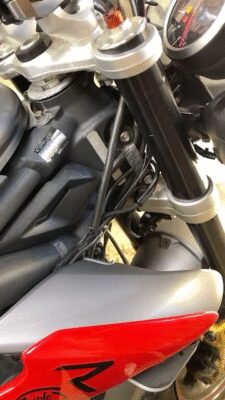

    2025-10-14 at 09:27
    This is the startup sequence focused on the front camera, mounted below the triple tree. It simply doesn’t turn on. It will turn on if I press the button to activate it manually. The BSM system works from startup with no issues.
    1:31
    IMG_0918 (1)
    1:31
    • This reply was modified 1 year ago by  Corey.
    2025-10-15 at 00:38
    Hi Corey,
    Check all connections carefully to make sure they’re secure.
    Is there any damaged cable?
    If you started the RC6 manually, does it record video properly? Does it record video with the rear camera as well?
    If you remove the SD card and then start it up, what happens? Perhaps try a different SD card?
    Have you tried reloading the firmware?
