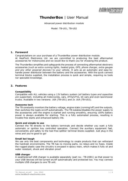

    Hi, here is the Thunderbox manual. It is a distribution box that enables you to add additional electrical items easily.
    It just appears it’s not letting me switch the innovv K6 as I turn the ignition on/ off.
