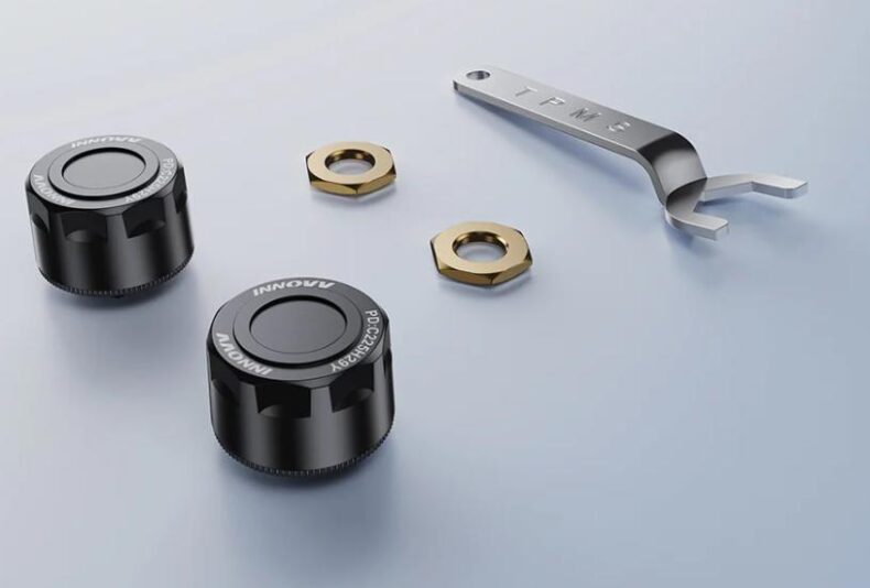

    Hi all, I’ve just installed my N2 with tyre pressure monitors. My N2 will not sync with them and are currently expensive tyre valve caps!! Anyone had this issue?

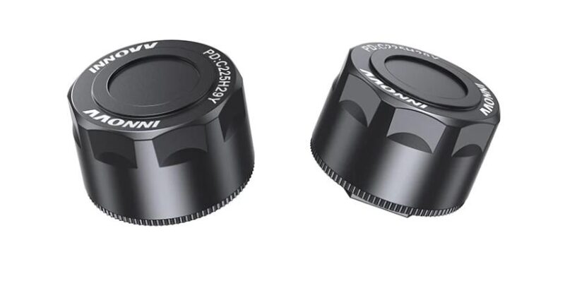

    Thanks Hans … the sensors i have appear to be sealed units? Not sure if they can be opened. I will have a closer look at them to see if there is access. Thanks

      If the sensors are the same as with the N1 (which I do expect), then they can be opened. After all, you also need to be able to replace the battery in the sensor yourself.

        These are what I just got with my N2 last week. How/where would they open? Does the bottom unscrew with the wrench?

          The bottom should be unscrewable at the ribbed edge.
