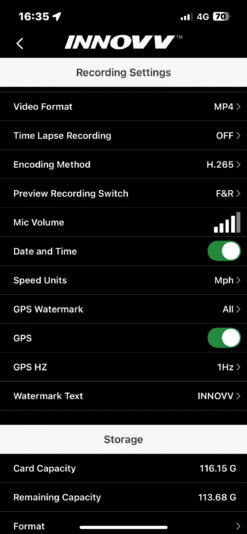

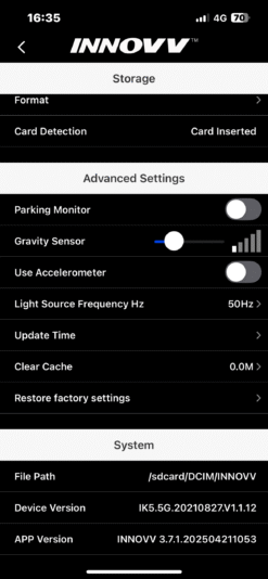

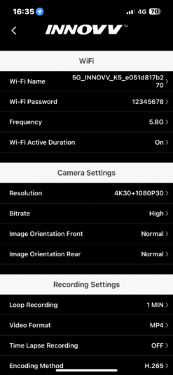

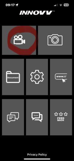

      Everything works as it should. I can view videos, download video, etc. I have just one problem. When I select the video camera icon (see image I’ve attached) I get a screen with no camera feed – just a flashing ‘REC’ message in red (see image)

    If you click the gear icon at the bottom while watching the live recordings, you’ll see settings where you can adjust the brightness and colors of the image. What are these settings?
    And if you’re only watching one channel, not the F/R one as you’ve selected now, does that make a difference?
    While watching the live video, do you have a good Wi-Fi connection? If not, try setting it to 2.4GHz.
