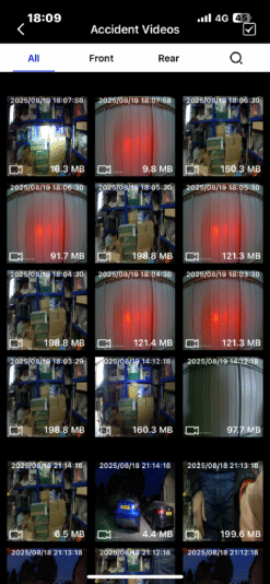

    As an example I’ve included screenshots of the Accident folder; ‘All’ shows F & R – ‘Front’ also shows F & F, but ‘Rear’ shows no videos.

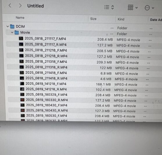

    The SD card was formatted by the App/K5 – I’ve also included an image of the current SD card file structure.

    I see the error in the app’s display.
    The display in the file explorer is correct. The front and rear recordings are saved in the same folder.
    Also attached is a print screen of the structure as it is in my case.

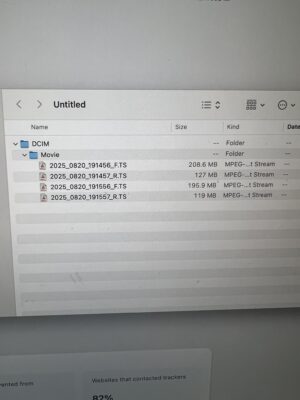

      I tried every version of the old firmware – each had the same result (see CD card file format picture).
