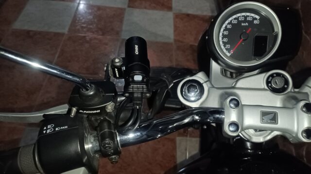

      Could you show/share where you mounted the dash cam on your bike?
  • guille
    2025-07-22 at 08:59
    I mounted it on the handlebars of my Honda CB350 H’ness. Unfortunately, I can’t share a photo right now since the entire system is currently disassembled

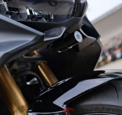

      My dashcam mount location on my cbr 650r:

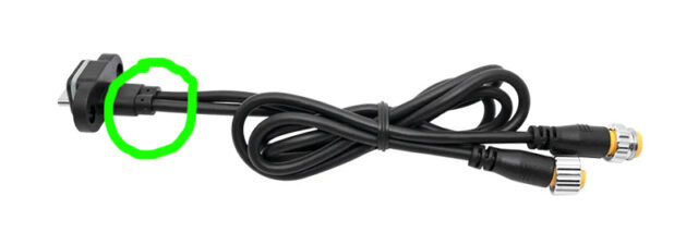

    The same situation has arisen as at the very beginning!
    After a year of using the new cable, it has failed again, and the DVR won’t turn off.
    If I wiggle the cable a bit or bend it, the DVR turns off.
    I believe this is either a factory defect or a design flaw. As a result, I’ve lost my second battery. How can this problem be solved?
      2026-06-16 at 00:45
      Hi Andrey,
      Does the cable move or vibrate a lot when you ride your motorcycle? Is the cable not tensioned too tightly?
      Excessive movement or tensioning can cause a cable break. Pulling too hard on the cable to remove the SD card cover can also eventually cause a break.

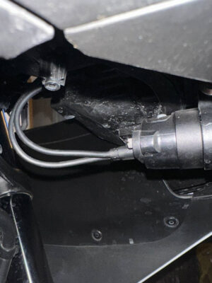

        2026-06-17 at 05:02
        Here is a photo of the recorder mount.
        The cable is not bent and has some free movement. It is also secured with two plastic holders from the K6 original package in the upper part of my bike.
        There is no additional load on the cable. I approached the installation process as carefully as possible.

          2026-06-18 at 15:47
          Hi Andrey,
          Looking at the photo, the wiring is properly installed.
          I am curious if it will continue to work properly with a new cable.
